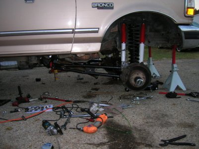

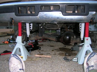

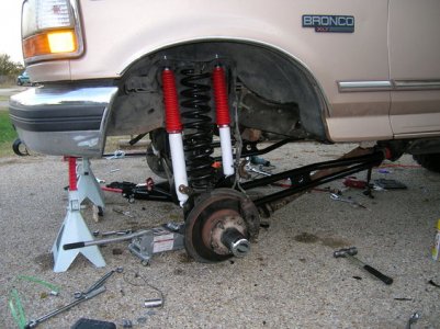

Got the front suspension hung. Still have to do the steering parts. I ordered all new parts from drop pitman arm to the wheels. It was getting late and the pitman shows no signs that it's going to come off without a fight even with a puller. Amazingly, with the exception of the pitman arm, everything else was a piece of cake to disassemble. (probably due to copius amounts of PB Blaster).
The re-assemble was not so smooth. Nothing major, but little setbacks kept putting me farther and farther behind my planned schedule. Here are the things that slowed me up:
1) Very thick powder coating on the Superlift extended radius arms. Caused parts not to line up and bolts not to fit through holes. Problem solved with a grinder and round file.
2) Front shock/swaybar mount bracket interfered with part of radius arm causing bolts not to line up with shock bracket, radius arm, and bottom hole in axle housing. Modified shock bracket with grinder for more clearance.
3) Cross threaded bottom bolt before discovering problem number 2 :angry: . Had to pull hub, spindle, and axle half to gain access to the other side of hole. Ran good bolt from other side through from top to straighten threads then used a small triangle file to repair threads on both bolts.
4) Two holes on drives axle drop bracket did not line up with factory holes. Easily fixed with a drill.
5) One radius arm bracket was bolted on and a piece of cake to relocate. The other was riveted on and a pain in the ass to get off. (relocation was as easy as the first one)

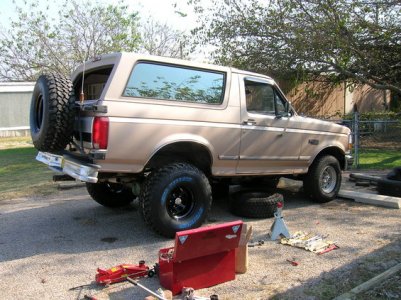

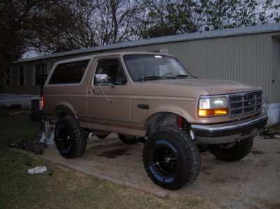

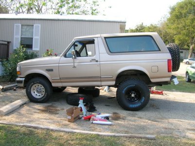

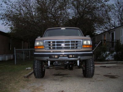

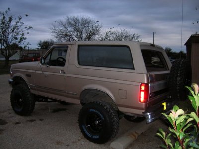

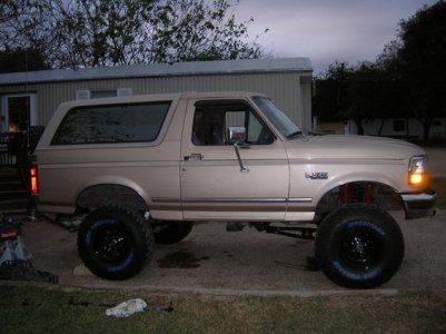

Here are a couple of pictures of how it sits right now.
Tomorrow, if all goes well, I'll get the steering put back together and see how she rolls down the road.
