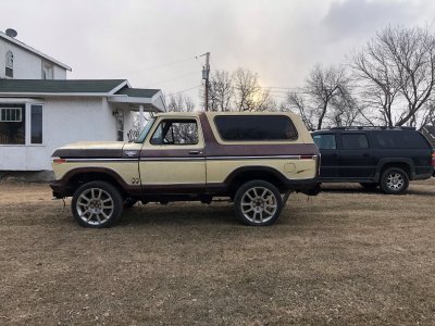

Made some progress this weekend. First powered flight! A looong way to go still, but went forward, backward,(with B\U lights), stopped, Blew warm air from the heater. and a few more milestones!
It may not sound like much, but with the depth of the build, It was monumental for me!!

Don't worry, those wheels aren't staying, they are the summers from my Harley f150. Needed something to move it around on with the new bolt pattern, the white spokes won't fit anymore!

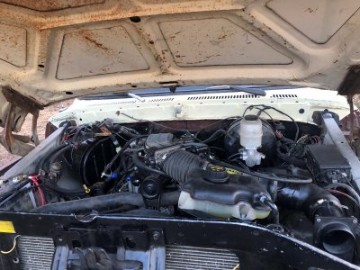

View attachment 29762View attachment 29763
Good for you bud. Now are you gonna park it outside? If you do. I notice something under the hood. You might want to order. The rubber piece that goes across the firewall. I see yours rotted off. Replace it and it will keep the rain and snow from getting under the hood. They were $15 at Jeff,s a couple of years ago. They do help alot. I went to start mine the other day--and I had a wire on the solenoid break off. I,m trying to find another connector.So I can replace it.
Thanks Johnny, will do.
It will live outside off and on. (I don't want to lose momentum.)
I need the shop to go through my F-150. We are headed to Boise Idaho in 2 weeks for a drag race. I'm taking my trailer to stay in. (can't stand hotels)
Gotta give her a look over before we hit the road.
Good luck with your solenoid wire. Make sure to get a solder on one. The crimp type fall off or corrode too quickly.
