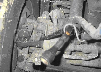

Warn® Standard P/N 9790 & Premium Hub P/N 20990 Instructions & Diagrams; "...These instructions are what comes with the Warn Premium hubs. If the original autolock covers have 3 screws, you will also need the spindle nut conversion kit. If you have five screws, this box contains everything you need. "... Install the Axle retaining ring. If necessary, a pry bar can be inserted into the knuckle (universal joint) to hold the axle shaft outboard while installing the axle retaining ring..."
Source: by Warn® @ http://warn.iwebcat.com/imgVD/WAR/61420C0-pn20990.pdf
5 ***** to Warn® in an 89 (no torque specs); "...Next, your ready to install the manual hub. As you can see in this picture, the snap ring gruve is not visible, and thus cannot be accessed. The snap ring must be installed. As I was doing this project "Lone Ranger" style, I needed to apply outward pressure on the axle shaft u-joint. The only way I could quickly resolve this was to place a standard crow bar behind the u-joint and using a black rubber tie-down strap to pull tension on the crow bar. I simply hooked the other end to the Pittman arm..." read more
next pic @ http://i173.photobucket.com/albums/w69/FDbronco/Manual%20Hub%20Swap/12.jpg
Source: by JD_bronco, (Dave, John D, jdbronco)
