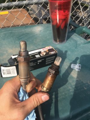

~ New O2 Sensor in exhaust. (Im thinking thaat if the O2 sensor has carbon on it it can't read an accurate air.fuel mix.) and DONE!
The Old one is on the right and new on the left. The Box has a Nascar performance Logo so that must mean I'll get +10hp to the rear wheels now? :))
