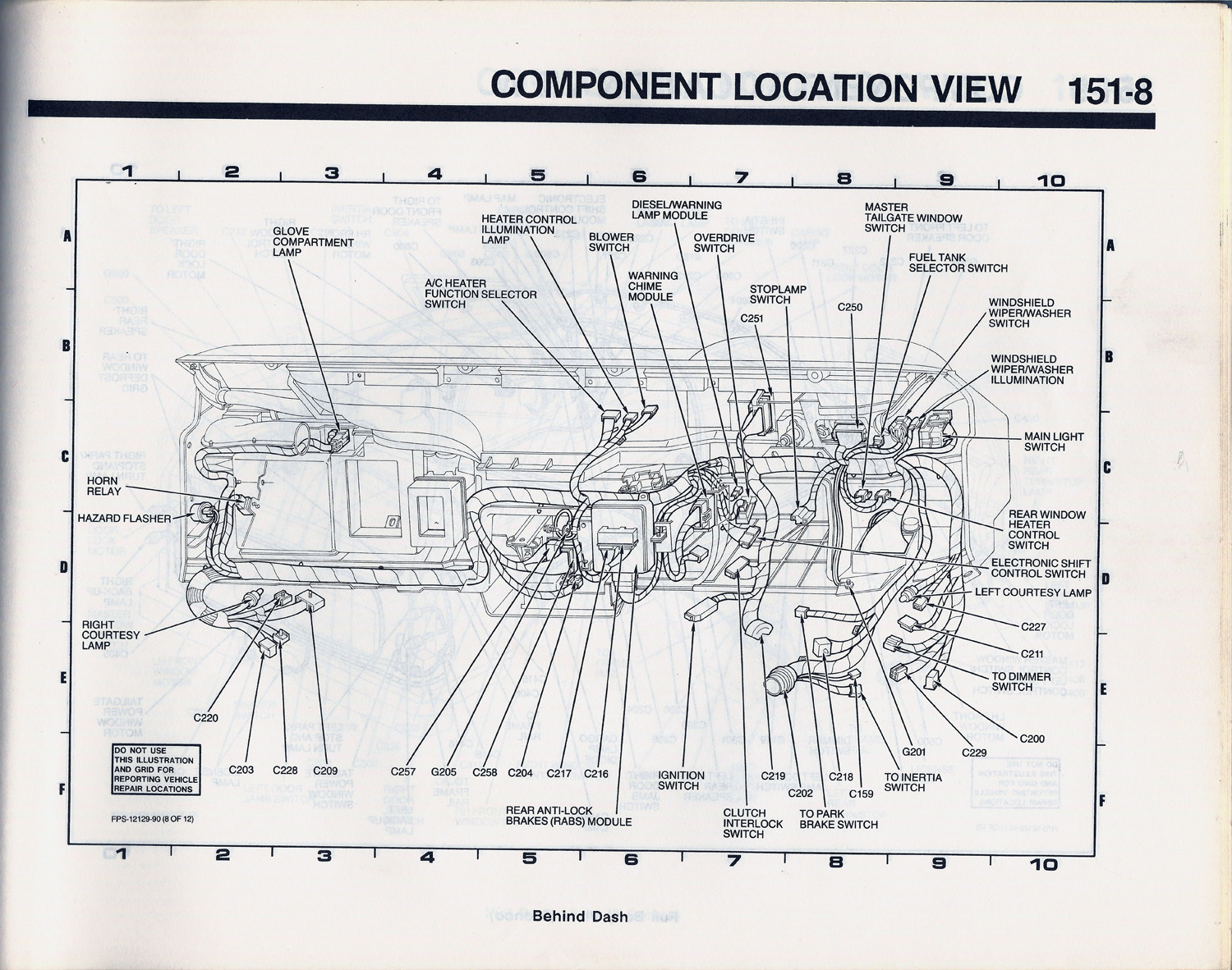

What are the key points I should check on the truck? I followed the wire from the tank and it goes into a sheathing, and it looks like it goes up into the floor.
yo MICHAEL;
Testing & Connector Pin-Outs in 92-96 Bronco (87-96 F-series & Bronco similar); Sender Range: 16 Ohms Empty; 160 Ohms Full; "...
gauge that pegs past full indicates an open circuit (broken wire; unplugged connector; corroded terminal; burned sender) on the Y/W wire.
gauge that pegs past empty indicates a short to ground (pinched to the frame, body, or dash supports) on the Y/W wire, OR a sunk float.
gauge anywhere in between that doesn't move indicates an open circuit (blown fuse; corroded terminal) on the power (battery) side of the gauge OR a bad instrument cluster ground at C251 pin 9.
The terminals of C251 (& C250) are known to corrode & lose contact. Polish both the connector pins AND the film circuit pads with brown paper or a pink eraser.
The larger version of C441(WPT454) was used until 93. The level sender can usually be disassembled & repaired by bending the wiper arm inside the plastic housing to apply slightly more force..."
Source: by Steve83 (Steve, That dirty old truck) at http://www.supermotors.net/registry/media/744437
C251, Location, Behind Instrument Panel Diagram by Seattle FSB (SeattleFSB) at http://www.supermotors.net/getfile/860017/original/1990-component-location-view-1518.jpg
