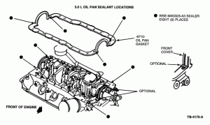

Initially, I thought I had a bad gasket, or it wasn't making a great seal so I grudgingly tore everything down again. I warrantied out the first gasket and reinstalled. Same results... At this point I'm thinking I have a warped pan or shouldn't be working on vehicles 🤬 . In frustration I scoured the threads for info. Miesk posted a TB regarding dotting the corners.
Oil leaks drive me crazy so I pulled everything apart again. I applied rtv to the corners as shown (including the optional area) and so far no leaks! I did not apply rtv where timing cover attaches to the block but It didn't seem to leak there.
I wanted to believe that nice permadry gasket wouldn't require rtv but I was misguided.
