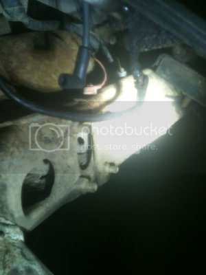

I took a picture of the passenger side. Do I just move the mount forward to two bolts in front of the mount.

i thinnk thats correct. you'll have to take a few measurements from the motor mounts to the trans mount surface to the mating surface of the transfer case. i believe thats what brought me to that result. i actually used the round style tranny but had the center shaft swapped from the original tranny that was in the bronco. thats what remember doing.good luck bud. remember to measure the total length of your swap as that will determine what you will have to alter.

Well got it put in. Moved the towers forward an bolted up. I'm from troy Ohio.
