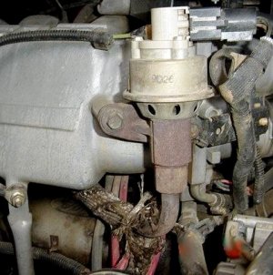

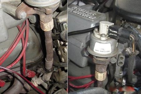

I know that the 96 EGR tube and some other emission parts are diff between 5.0 & 5.8
EGR Tube (also called, AIR Tube); The 1996 5.0L Air Tube is connected to an exhaust passage in the intake manifold and then goes to the EGR Valve, while the 5.8L is connected to the passenger side exhaust manifold
5.8 EGR Tube
5.0 EGR Tube
pics by Ryan M
