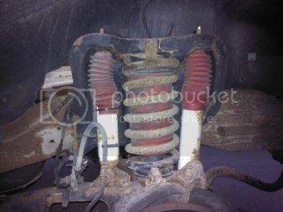

The 2" leveling springs i refer to do raise the front another 2" over stock mainly to offset the weight of extra components up front, or just to add another 2" to get the front level to the rear. Most 4X4 vehicles have a slightly lower front rake from the factory to begin with.
I need to replace the broken springs (top coils) i have along with new ball joints and shocks. I want to get the front back up to a level stance while i'm at it. When i purchased the bronco 10 years ago i got it with 20,000 on the odometer. It has a coil spring wire diameter of .850, compared to most replacement springs that run in the .720 range. It also has airbags which was not a factory option, so the sprngs may also be aftermarket. I'm guessing it was setup for a plow that never was used.
"......that will fit my dual shock setup in my Bronco."Why is this an issue..? Duals are quite common. :unsure:/>/>
Most of the stock length replacement springs i have found were for single shock setups. Appparently the spring diameter is too large to use with dual shocks and will rub the closer shock.

springs are the same for quad shock or not, the shocks are equally spaced on either side of the spring. If you can find a progressive rate spring in stock ride height you could always use a 2" leveling spacer/ block under the coils which would give you the progressive springs with the lift you want.

If springs are the same for quad shocks or not, than how come 80% of the springs i see online say "not for dual shock suspensions". My guess was that the diameter of the spring was a little larger on those than a dual shock spring. Again, just a guess.

This is how it looks now. I'm hoping with new springs, shocks and ball joints, and new tires, it will ride much better. Thanks Ron for that alignment insight. I would like to know exactly how it should be set up with 33's so i can have my tire shop do it right for maximum tire life.
