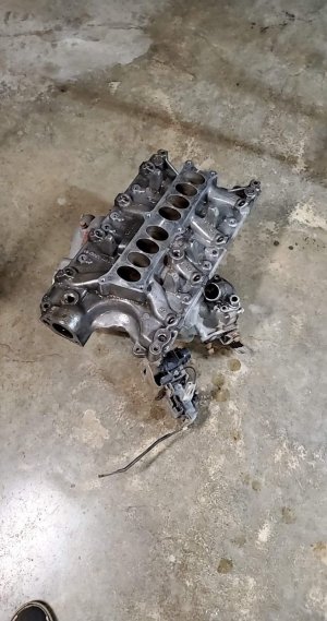

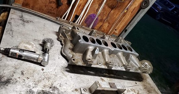

Took a lot of elbow grease to get a intake cleaned up after 25+ years of crud buildup.
Looks like the last revision on this particular part was in '88 by the casting #, so may install this one and run it.
Will be doing a detailed inspection of what's on the jalopy-motor just to make sure.

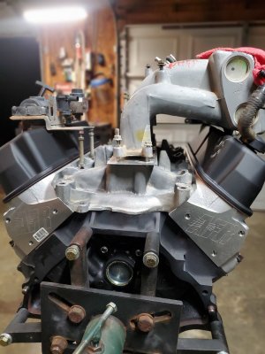

And now we pause for more then a brief moment of 🤬 cursing and swearing......
(Somehow I just Knew this was gonna happen)
L- here's that 'Train' I was concerned about.
So now the search for the proper 1" spacer gets started. 😑
This mock-up is using a '97 plenum.
It's interesting that the PCV tap is not there on this unit. Not sure when that revision was made.
Anyone know if there are any other differences in the plenum design between the early 90s vs the later Last Ones?

They moved the pcv grommet to the valve cover (dont remember when)

Even odds it was post '94 when the roller motors appeared.
Were changing more around like the air-in-manifold stuff to, trying to squeeze everything they could out of the pushrod motor before hatchet 🪓 time.

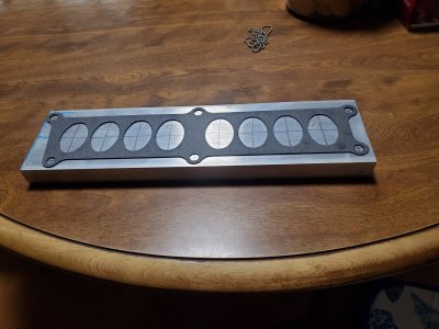

Looks like I've painted myself into a corner with this build. Nobody out there seems to make a spacer gizmo for this particular OEM manifold setup.
Custom fab, here we come. 😕

A quick stack-on, plenum sits down & clears everything just right.
So, it goes to local industry next....🔫

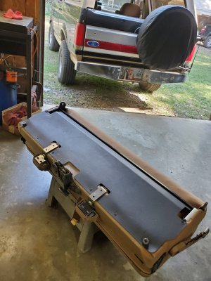

Removed the back seat, clean & apply de-rusto to affected components. Stored seat in the attic since it's not really needed for now. Makes for a fair amount of area- & must be 70 lbs lighter.
4X module tested good, so looks like a fresh actuator is in the hopper.
