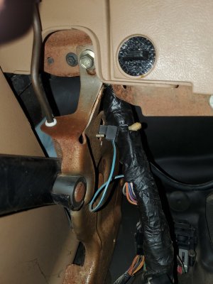

Hey Jimbo, check the wires to the sensor near where they go by the park brake cable. (They used to rub through there a lot)
If you need to fix the wiring, make sure to twist them at least 9 twists per foot.
EMI really causes havoc in the old control system, (especially the trans!)

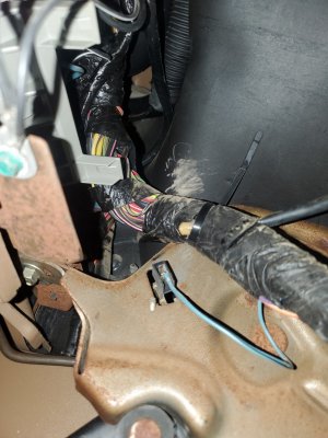

Well, today was change out the rear axle Ss and & the dash is still lit up. Diag. shows a code 4
Not really sure if I need to replace the blasted valve just yet.
Not seeing anything obviously wore into on the wiring.
Did notice that the harness had sagged down on the park brake indicator connection so installed a anchor-zip tie to 'handle' that.

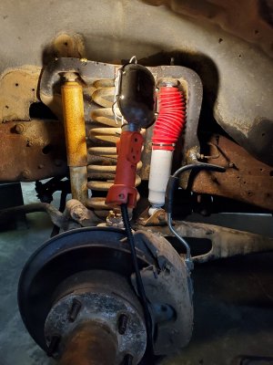

Swapped out the auto-lock hubs for manuals.....and discovered that the front end on this thing is a quad-shocker.
Dang, gonna have to order 2 more shocks now.

Did the extra trans-cooler install & a fresh set of shocks (-2)

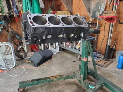

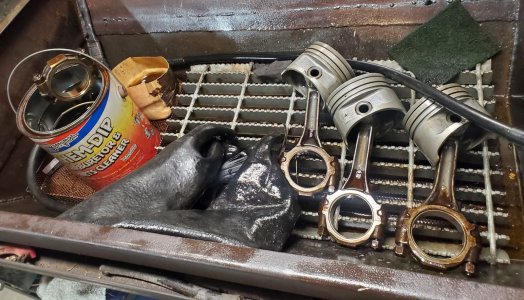

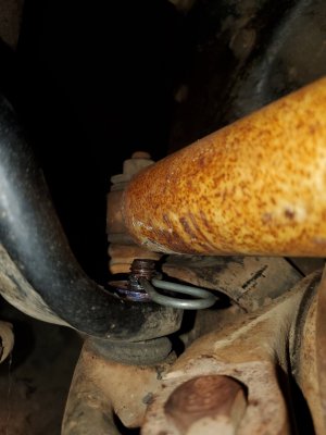

Shocks done, made a po-boy disconnect for the front sway bar. Rear linkage will be a bit more involved, but can-do. Dug into the F4 block a bit more (good call)
Edit: Full overhaul- mains, cams & O.P. Might as well 'zero time' it. Waiting on parts now.

Made a mailbox run with the wheez-bag jalopy motor once again. Sometimes the poor thing wants to run ok but eventually relapses back into a rolls-kinardly. May go ahead and put liability on it just to see if it'll make the 3 miles up the road to the liquid-gold station. The running gear seems to be working out the rigormortis ok.

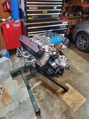

All back together on the lower end, now for all the test-fitting on the topside stuff.

You better be careful now.
That engine is gettin so pretty it'll be a shame to put it in that ol Bronc, without dressin IT up a whole bunch more too!
Itll get covered up with all the EFI junk, so there goes a lot of the bling. (sorta a shame, yeah)

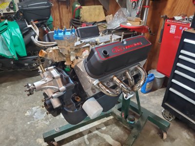

Having fun with pushrod geometry for now. Had to get the machine shop guru involved, so should have that whooped by late tomorrow, then can put a intake & plenum on to start the mock-ups with the other components- ign coil, etc.
Kinda handy to have all that extra stuff to help get everything right before hand, that way it all drops in together & no back-pedalling once the swap is done.
A little further along on the mock-up....
