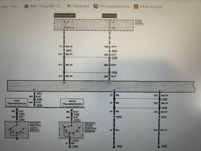

Hey Jimbo, heres the wiring diagram for the power and ground on your t/case. Make sure you have power at all times on A8 (black with a white tracer) and run power on A7 (white with a pink tracer)
Could be as simple as a fuse

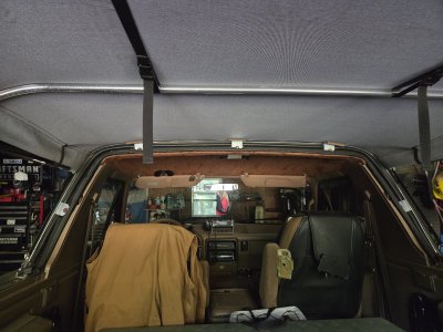

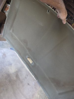

Fwd to the saggy headliner fix.
All the OEM fabric removed and the foam backing stays in place.....ALL of it 😳
Not done this particular chore in over 30 yrs and never saw this happen before. Another real 🤔

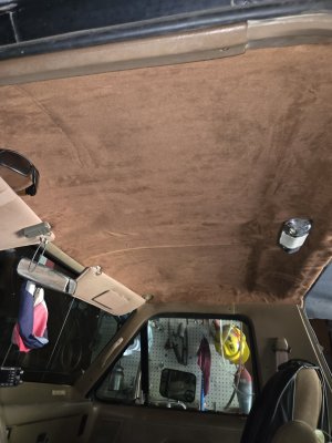

All back together again. Is it a perfect match? No, but its way better then the torn saggy stuff it replaced and super plush. Did what I could to address the rear view and made a tuck-n-fold on the back edge of the liner. Not so cut off looking. Kinda surprised things went as easy as it did, the material took a fair amount of extra adhesive to make stick, especially around the edges. Maybe this will hold up for a while 🤞

I appreciate it, folks.
The 2-tone deal makes for a interesting .....Contrast
(I believe thats the correct phraseology) 🤔
Getting the new foam backed liner material to stick to the OEM foam has proved to be a bit dicey.
A small part right above where I sit has already tried to part company 😡
All else is holding good, even in this consistent 99☀️100° temps we have been enduring here as of late. 🏜If that doesn't test an adhesive, nothing will. So far 3M is hanging pretty tuff.
