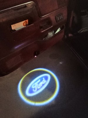

Ground effects are groovy 😎
When living in deer 🦌 country, so is extra armor.
