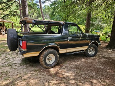

3G Alternator upgrade accomplished and on line.
14.5 V @ 130A- good to go👍
Hey L, the 'mystery' green wire Was the one. It did everything possible to conceal the red line. Had to twist the thing 180* to reveal it. (typical-typical🙄)
The G/r is the power wire that has that black plastic squeeze-lock connector on it which looks as if should have a old style bus fuse inside......but is just a connector.
Other then that, a bit of die grinder work on the inner side of the bracket & some circuit protection. Done deal. Time to get some more miles on this critter. đź›»
