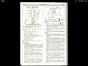

miesk5 Note; don't replace ignition switch unless it fails this Logic Test; Switch Pin-Out Diagram & Continuity Testing (Logic Tables in 87-91 (from Factory Manual and the Ford Electrical & Vacuum Troubleshooting Manual (EVTM)
Source: by Broncobill78 (Dave) at Ford Bronco Zone Forums
http://broncozone.com/index.php?app=core&module=attach&section=attach&attach_rel_module=post&attach_id=6659
miesk5 Note, due to recent Bronco Zone "site upgrade", the Logic Test is gone. But here is a copy I have in my site;
