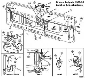

Yo,
Here's a better diagram;
83-96 Bronco Tailgate Latches
ERRORS: there are several 6s & 7s...
1 - Tailgate Latch Remote Control
2 - Screw
3 - Tailgate Latch Release Handle
4 - Plug Button
5 - Rod Guide Clip
6 - Remote-to-Latch Link Rod
7 - Screw and Washer; tighten to 3-8 N-m (2-6 Lb-Ft)
8 - Tailgate Latch Bracket
9 - Interlock Rod
10 - Screw and Washer; tighten to 8-14 N-m (6-11 Lb-Ft)
11 - Rod Retainer Clip
12 - Guide Clip
13 - Bushing
78-82 tailgate latches are significantly different from '83-96. Because they mount differently in the tailgate, neither the latches nor the t/g skins will interchange across those years. This is the only significant difference on '78-96 Bronco tailgates.
