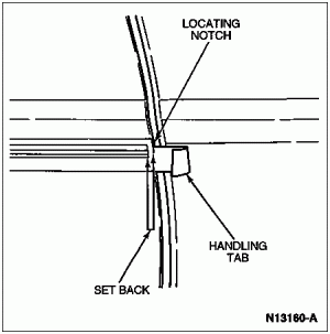

ani_caut.gif CAUTION: Handling tabs must be used as illustrated to reduce the possibility of fingers coming in contact with the adhesive side of the tape stripe.
  1. NOTE: Freshly painted surfaces must be thoroughly dry. Residual solvents in freshly painted surfaces may cause tape stripe to blister. Fingers should not come in contact with the adhesive side of the tape stripe. The recommended ambient air temperature should be at least 18.3°C (65°F) or above for tape stripe installation to be successful.
    Clean all surfaces that will receive the tape stripe with Silicone and Wax Remover DL60-3271-A or equivalent. Wipe surface dry with a clean, dry cloth.

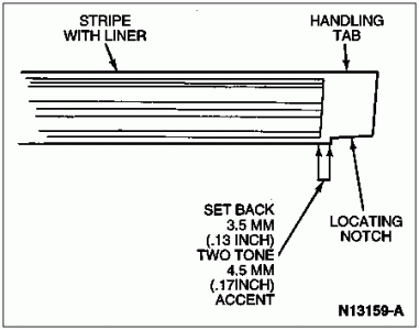

  1. Position carrier edge or locating notch on tape stripe to body openings and/or character lines on the vehicle. The tape stripe has a setback of 3.5mm (0.13 inch) (two-tone) or 4.5mm (0.17 inch) (accent) on both ends from panel edge. The tape stripe also has a 20-30mm (0.78-1.10 inch) extension on the leading edge of the tape stripe liner to act as handling tabs. The locating notch should be positioned to the panel edge. This will aid in the positioning of the designed setback from the panel edge. Tape stripe DOES NOT wrap around panel edges.
