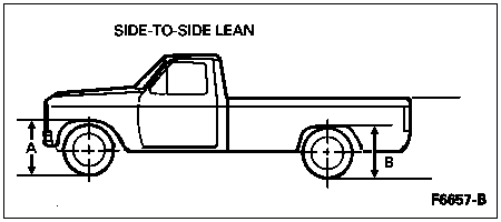

Side-to-side vehicle lean should be verified by measuring the fender lip-to-ground dimension before beginning diagnosis and service actions. Normal acceptable limits are:
Maximum of 16mm (5/8-inch) variance between left and right front wheel lips to ground.
Maximum of 19mm (3/4-inch) variance between left and right rear wheel lips to ground.

Jounce the vehicle's front and rear suspension to normalize the vehicle static ride height.
Measure the height of the right and left fender lip openings for both front (dimension A) and rear (dimension B) .
Calculate the side-to-side differences for each dimension. If these differences are greater than 16mm (5/8 inch) between left or right front and/or 19mm (3/4 inch) between left and right rear, adjustment can be performed following the Vehicle Lean Correction procedure.

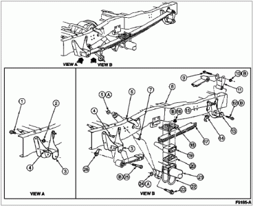

Rear Lean
A side-to-side lean at the rear of the vehicle can be adjusted by approximately 10mm (3/8 inch) by installing a shim between the rear spring (5560) and rear axle (4001) on the low side of the vehicle. A "low at the rear" vehicle can be raised approximately 10mm (3/8 inch) by installation of one shim on each side. Use the following procedure to install the shim (D7TZ-5742-A).
- Raise the vehicle frame until the weight is off the rear springs but with the tires still touching the floor.
- Loosen the spring U-bolts to allow the rear axle to separate from the spring approximately 13mm (1/2 inch).
- Position the shim (D7TZ-5742-A) between the spring and the spring seat and with the tie bolt head through the hole in the shim. On 4x4 vehicles, position the shim between the rear spring and axle spacer. Tape may be used to hold the shim in position.
- Make sure the spring leaves are properly aligned and the spring U-bolts contact the edges of the spring assembly or axle seat.
- Tighten the spring U-bolt sufficiently. The spring bolt end should extend through shim into axle seat hole.
- Tighten U-bolt nuts to the following torque specifications:
- 102-135 Nm (75-100 lb-ft) on F-150 4x2 and 4x4 and Bronco.
Check if Rear Spring Clamp is Damaged or missing.
