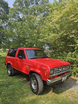

Im having a problem with my 88 B2 fuel pump. Recently replaced inirtia switch. It's now acting the same way. Since I had to get a used one I thought it was the same problem. I jumped the connector...nothing. have power to switch but when I jump it I have no power. Ran a new wire to fuel pump have power to connector, but when I plug it in, nothing. Anybody got any ideas.

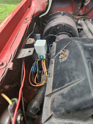

Finally found the problem. What i thought was the fuel pump relay was another relay. Found the green one laying down beneath a pile of wires and hoses. The harness wires were cracked, corroded and exposed. Replaced the harness and relay and secured it back to the fender well. Good to go and only took 15 minutes and 30 buck for relay and harness. Thanks to all who responded. Especially the guy who replied "it's the green one".
