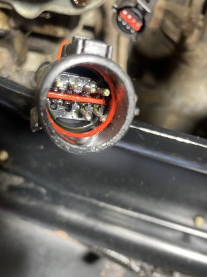

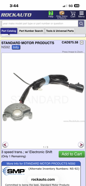

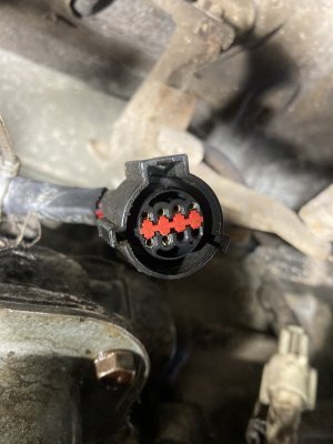

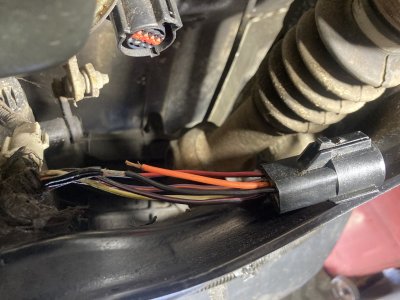

Here are a couple of pics. The picture of the one with female end ( middle pic.)is the one on the NSS. The one of the male end ( trucks wiring harness) shows that it is only using 6 pins of the 8 pin plug. I also posted this pic because when I removed some of the factory tape ( it was oil saturated and coming loose) I found the area on the black wire stripped and the other wire end stripped. It does not look like the two wires were ever connected together though. Once again I purchased this bronco new in 1989 so I know its entire history and I know for sure that no one ever messed with wiring for the trans. Since my last posting I have ordered another electrical repair manual I hope that will have a more accurate schematic of the wiring system. Any help is much appreciated. Thanks Again, Rich

There is lots of info out there, if you have a man t/case it uses the 4 pin version. The 6wire one is for an electronic shift t/case.
The part number you need is NS-92 For a “standard motor products” part.
Some guys are cutting off the plug and wiring it to the 4 wire version. The colours for the neutral start and b/u lamp circuits are supposed to match.
The other 2 wires are for a safety circuit in the electronic t/case.

I just ordered the part from Rock Auto. The problem I have had all along is whenever I entered in the engine, transmission and manual transfer case it would only give me the 4 pin plug option. Whenever I did an online search it never brought up a 6 wire configuration for a C6 trans. I didn't want to cut and splice any of the wiring on the truck unless I had no other options. Here's A picture of my bronco, I purchased it new, Lifted with 50 miles on it, It has been garbage kept since new ands less then 62k miles on it as of today. Thanks again for all that you help, RichIMG_6028.jpeg

Just wanted to update you on the NSS, I ordered it form Rock Auto, it arrived yesterday and it is the correct plug for my truck. ( I probably won't get around to installing it until after the weekend. Thanks for all your help, I'm still a little confused as to why my truck has a 8 pin 6 wire plug with a manual linkage transfer case. Do you think it could be that my truck was built so close to the factory changeover to the 1990 models? Didn't Ford go exclusively to Electric shift on the 1990's and newer? Well thanks again and hope you have been enjoying the holidays.

You might want to check the BACK-SIDE OF THE PLUG IN. On my 78 their was one wire broke of--nut still LOOKED like it was all the wan down. Nice looking Bronco.

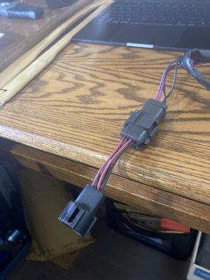

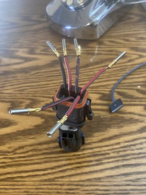

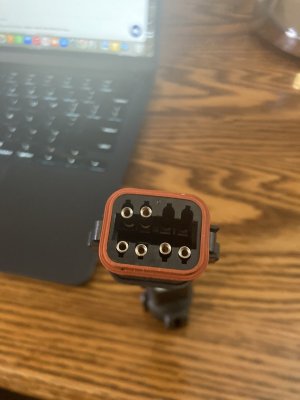

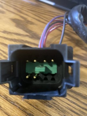

I figured I would give you an update on the Neutral Safety switch saga. I Installed the NSS in the truck yesterday, got ready to plug it in to the wiring harness on the truck and realized I had two identical plugs. Both plugs were the male end (female pins) . I Removed the new NSS Cut the plug off the old NSS and installed a Weather proof plug in the new switches harness instead of splicing the wires on it.( luckily the wires on both the old and new switch were the same colors ) I Reinstalled it and everything is working as it should. Once again I believe it is due to very late build date on my 1989 model and Ford using up both old and new harnesses, parts and pieces. Here's a couple of pics of the plug I installed on the NSS instead of just splicing the wires. Thanks again to all for your help and interest .
