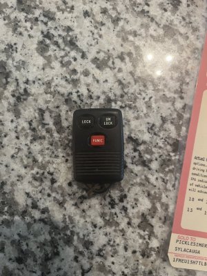

My ‘96 Eddie Bauer came with keyless entry per the attached window sticker. However it doesn’t work. All I’ve done is put a new battery in the remote. I’m not good at understanding wiring diagrams so I’m wondering if there’s anything obvious I could check?
I’ve attached a photo of the fob wondering if it looks like what came with and the window sticker that shows it’s part of the package.

The remote looks right.
