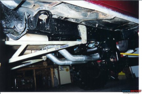

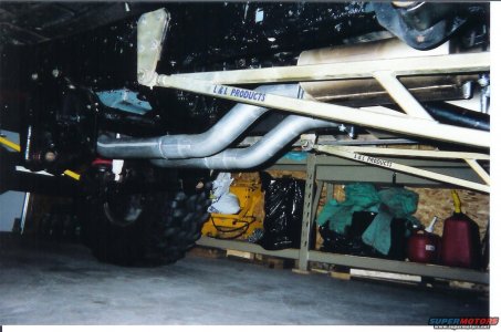

Justshootme84,here's some picture's of my exhaust.There ****** headers with 3" mandrel bent pipe that go into 2 Flowmaster 40 series Delteflow mufflers.
The only thing I wish I would of done different is byt the stainless steel Flowmaster's.

Thanks for the pics Freak, that's the set-up I'm looking for, except with glasspacks/ GP's. I listened to your sound clip, and that's way mo' better than what I have now. Only problem I might have is that there are no cat's/ catalytic converters. That's what keeps me from doing that, so I ask you guys that said the pipes are routed above the crossmember on the passenger side. Do y'all have a single cat or 2 cats?
GQ, I have also heard that emissions laws in Alaska are similar to California, you must keep everything stock. It's not as tough here in the country in Texas, but the big cities like Houston & Dallas have emissions or smog testing. Therefore, no local shop will install headers, remove cats, or do any mods that change what is stock equipment on that year model. No inspection station will pass you, either.
I think I'll just run straight pipes up thru the hood on either side of the shaker!!!!

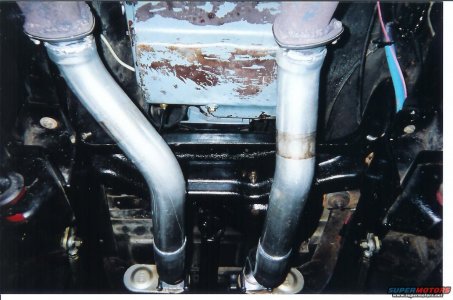

i have the cats in my set up i just cant remember where they are. but it is basically set up just like freaks. only my exhaust tips run all the way to the rear and turn out to the sides so when i start it up anyone standing next to the rear tire gets a little wet. but i promise i will take the pictures this weekend.

ok i couldnt wait i went on my lunch break to take the picture. first my cats are located under the driver seat and the passenger seat. and the picture is sloppy because i used a friends camera phone. but on pipe runs under the passenger seat around the t-case and the other runs under the driver seat and over the t-case which is possible because of the 3" body lift that nobody likes. but hah found a purpose for it after all huh. oh yeah here is the picture
J
Thanks gunner!!! I haven't thought much of the body lift thing, but that would give me more room. Now you know why I want a 78/79 Bronco--no cats!!! I was shocked to find I had two cats on my 84 Bronco when I got the new Flowmaster installed. Of course, both of them fell out on the ground when the shop cut out the old muffler!!!
I decided that after my next inspection (this month in May), I will just go with headers straight into GP's and out the back at an angle. If that's not street legal, then it will just be a trailer hog for racing and on the farm. I just wanted cats for each side, and I don't see that working for me.
