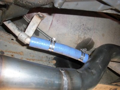

My 96's check valve rusted out and grenaded too, souned like a bad muffler leak especially when accelerating.
Also, check vacuum hoses to the combo TAB/TAD Valve
and the line to the cat converter.  Some owners forget to use high temp rubber hose
J
