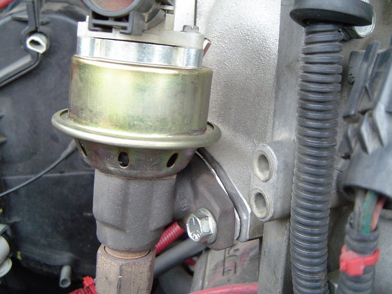

miesk5 Note, see EVP pins by SeattleFSB @ EGR Valve Position (EVP) Sensor Testing & Replacement
"And, I did find this, "here's an even easier way; once the EGR valve is removed off the car, remove 3 small (7mm?) screws to disassemble the pintle assembly (EVP) from the EGR valve body. plug the EVP back into the wiring harness and push the steel pintle in about halfway and using strong tape (green or red duct tape works best), wrap the tape over the pintle so that it holds its halfway-in position. hide the pintle assembly out of sight. I've run my car like this for at least 5 months now and no check engine light. No soldering needed, no money spent except if you need to buy tape and its still safe and reliable. just remember to put an EGR delete plate over the opening in the upper intake, a cap over the heater tube opening on the passenger side header and plug off your 2 or 3 (now disconnected) vacuum lines." by cobraman1024 @ Ford Mustang Forums
EGR Location & Block-Off Plate pic in an 89 @ https://www.supermotors.net/getfile/439467/fullsize/dsc02766.jpg
Source: by Tim C (TnTbronco2, Trail Truck, Street Truck, Crazed, Broke, OoG)
