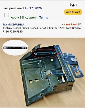

I recently ordered the ashtray guide replacement kit on Amazon for my ‘96 EB Bronco. The left side of the ashtray sagged and needed repair. The original guides fail or break so new exact replacement guides are needed. I watched a helpful YouTube video for disassembly guidance and installed the kit. Easy fix that worked well, however I had an issue with reassembly where the ashtray wouldn’t slide into the frame easily. The problem was that two of the 4 screws for the new guides were *slightly* too long so they hit the sides of the ashtray. Easy fix by adding a small washer under the heads of the screws. Here’s a photo of the repair kit:
