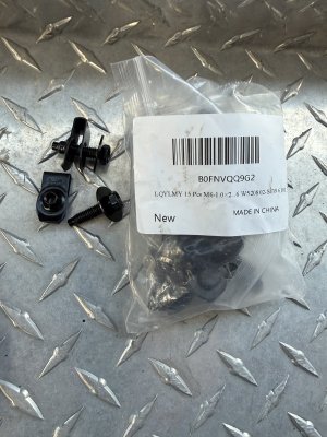

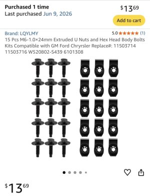

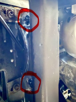

While replacing the headlights on my ‘96 EB Bronco, I noticed 2 header panel bolts were missing. I removed one of the other header bolts and found exact replacements on Amazon. Size M6 - 1.0 - X 24 with new direct replacement U nuts. 15 sets for $14.
15 Pcs M6-1.0×24mm Extruded U Nuts and Hex Head Body Bolt​
