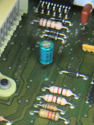

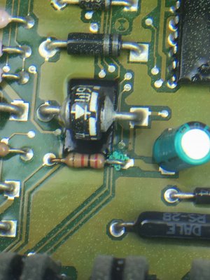

The issue with my Bronco seem'd too erratic. Transmission issues,  injector issues, code 33 improving how the Bronco felt to me as the driver. I gave up checking for sensors and went for the EEC. Found out I have a damaged EEC IV unit.
Brown spot under Capacitor.
Green fuzz under the resistor and under
Skitter302

I could try but the green corrosion by the other chip is harder to fix and could still be an issue.
I've got the New ECU from http://www.fiveologyracing.com So I'll swap that In an hope that this ends my drive-ability gremlin. Looks like acess to the injector harness on the pass-side of the engine involves taking off the upper-intake. I'm still thinking about a set of injectors since I have to take stuff apart any way.

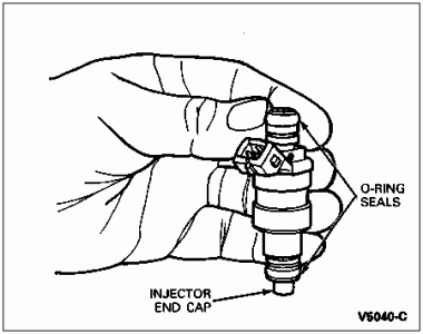

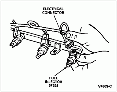

Fuel Injectors
Removal
  1. Perform Pre-Service procedures as described in Fuel Charging System in the Removal and Installation portion of this section.
  1. Remove upper intake manifold (9424) as described in Section 03-01B, and fuel injection supply manifold (9F792) as described in Fuel Injection Supply Manifold in the Removal and Installation portion of this section.
  1. Carefully remove electrical harness connectors from individual fuel injectors (9F593) as required.
  1. Grasping fuel injector body, pull up while gently rocking fuel injector from side to side.
  1. ani_caut.gif CAUTION: Do not attempt to clean the injector metering orifice with brushes.
    NOTE: Deposit resistant injectors (DRI) do not need to be cleaned.
    Inspect fuel injector O-rings (two per injector) for signs of deterioration. Replace as required.

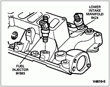

Installation
  1. ani_caut.gif CAUTION: Never use silicone grease. It will clog the fuel injectors.
    Lubricate new O-rings with light grade oil XO-10W30-QSP or equivalent oil meeting Ford specification ESE-M2C153-E and install two on each fuel injector.
  1. Install fuel injectors using light, twisting, pushing motion.
  1. Install fuel injection supply manifold as described in Fuel Injection Supply Manifold in the Removal and Installation portion of this section.
  1. Install electrical harness connectors to fuel injectors.
  1. Install upper intake manifold as described in Section 03-01B. Perform Post-Service procedures as described in Fuel Charging System in the Removal and Installation portion of this section.
