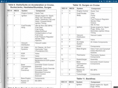

For now, Table 8 Stumbles, Surges, etc
Quick Test is Self Test

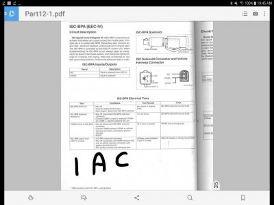

Idle Air Flow is IAC:
See my Vacuum leak test in post #11 @ Help with dtc codes and idle
