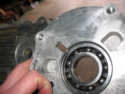

There are (6) ½” bolts that hold the Tcase to the tranny housing adapter. It will leak just a little once unbolted. There is very little room between the Tcase bolts on the passenger side and the stock exhaust. The bolts are not that tight since it’s all magnesium (torque on these is about 40 lb/ft., they had traces of red locktight on removal, so I used a little on reinstall. NOT the permanent, just red locktight high strength). • You need a gasket (included in the seal kit, don’t damage it). It takes no sealant. Surfaces must be clean.• Chock the wheels and place the tranny in Neutral, making install of the slip shaft easier while “clocking” the rebuilt manual Tcase into proper position.109_0987.jpg
Make sure when you are putting the rear Tcase nose piece back on you don't cover that rectagular hole with sealer. That's a passage for fluid.

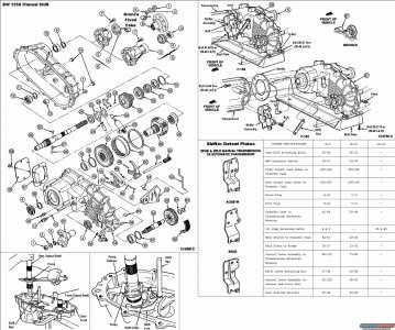

Yo,
Overwrote this:
BW 1356 Manual (F1TA-7A195-EA) Exploded (shown with optional PTO plate)IF THE IMAGE IS TOO SMALL, click it.1 7045 Shaft Nut (163-203Nm, 120-150 lb-ft)2 7B368 Output Shaft Yoke Washer 3 7052 Oil Seal 4 7B215 Yoke to ****** Seal 5 -- Extension (Rear Spline) Cap, Bearing (Rear Yoke/******) (Serviced As Part of 7085 Assembly) 6 7085 Extension Assembly (Rear Spline) Cap Assembly, Bearing (Rear Yoke/******)7 7A443 Bolt and Washer Assembly (30-49Nm, 22-36 lb-ft)8 -- ****** (Rear ******) (Serviced As Part of 7B214 Assembly)9 7917 Ring, Snap10 7025 Bearing 11 7917 Ring, Snap12 7100 Shift Collar Hub 13 7127 Caged Needle Bearing 14 7A010 Plug, Pipe (9-23Nm, 7-17 lb-ft)15 7917 Ring, Retaining 16 7D164 Lockup Hub17 7D126 Spring, Lockup18 7106 Lockup Collar 19 7177 Sprocket, Drive 20 7A210 Hose 21 382486-S Clamp, Hose 22 7A291 Pump Housing to Case Bolt (4-4.5Nm, 36-40 lb-in)23 7E215 Retainer, Pump24 7A152 Cover, Pump 25 7A149 Housing, Pump 26 7A250 Pin, Pump 27 7A205 Spring, Pump Pin 28 7061 Output Shaft 29 7100 Shift Collar Hub 30 7A398 Front Planet 31 7C122 Ring, Retaining 32 7A153 Ring Gear 33 7A098 Filter, Oil 34 -- Gear, PTO (with PTO Only)35 7917 Ring, Retaining 36 -- Ring, Retaining (Part of 7B215) 37 7166 Case Deflector Gasket (with PTO Only)38 7165 Transfer Case Cover (with PTO Only) 39 381673-S Bolt (with PTO Only) 40 7034 Vent 41 7E440 4WD Indicator Switch 42 -- Setscrew (Part of 7E440) 43 -- Fork, Reduction (Serviced As Part of 7289 Assembly)44 -- Facing, Shift Fork (Serviced As Part of 7289 Assembly)45 7289 Ford Assembly Reduction 46 7235 Roller, Cam (Service As Part of 7289 Assembly) 47 -- Pin (Part of 7289)48 7C430 Facing, Shift Fork49 -- Retainer (Serviced As Part of 7289 Assembly) 50 7289 Fork Assembly, Shift, 2W-4W 51 7240 Shift Rail52 7219 Shift Fork Spring53 7C349 Spring, Detent54 7C191 Bushing, Detent 55 7F063 Cam, Shift56 7288 Shifter Shaft Seal57 7B106 Lever, Shaft and Pin Assembly58 7005 Case Front 59 -- Pin Dowel (Part of 7005) 60 7L027 Oil Pan Magnet61 7917 Ring, Retaining 62 7061 Output Shaft 63 7177 Sprocket, Driven 64 7119 ****** Washer 65 7917 Ring, Retaining 66 7A029 Chain, Drive 67 -- Yoke (Serviced As Part of 7B214 Assembly)68 7005 Case RearF2TZ-7210-K 4X4 Shifter Assembly (Mazda R2, ZFLD)F2TZ-7210-N 4X4 Shifter Assembly (E4OD)F2TZ-7210-P 4X4 Shifter Assembly (T18, C6, AOD, ZFHD)F2TZ-7B051-A Control Rod (Mazda R2, ZFLD 7.25" OC)F2TZ-7B051-B Control Rod (ZFHD)F2TZ-7B051-C Control Rod (T18, C6)F2TZ-7B051-D Control Rod (AOD)F2TZ-7B051-E Control Rod (E4OD)The ZF/C6 shifter detent plate also fits the Mazda M5OD-R2.

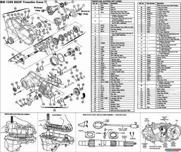

Hi miesk5,
I know its a ****** connection on the broncos (#6 in bottom bw1356 esof diagram).
What I am wondering is if #14(cap, bearing/extension - short stubby one for the bronco, part of #9 assembly) requires a gasket or some sort of sealant (to keep water out) on the side that connects it to the t-case?

Hi miesk5,
That manual had the answer thanks,
It says "RTV sealant on the mating surfaces of the transfer case and the bearing retainer"
