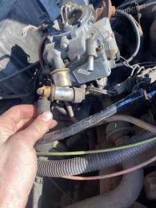

Hey guys so recently I bought a new carb for my 1984 Ford bronco it’s just a stock replacement and I’m having trouble with the choke flap on the top that lets air in. The old one almost sprung back to closed, and this one doesn’t seem to have that springy affect. Not sure what’s causing it to not work right.
besides that problem I broke a small plastic sensor which I will post pictures of but I can’t find the part number and I’d appreciate if anyone knew what it was called l could use your help!

I am not sure, but I think that is just part of the vapor recovery which is not all that important. Hopefully someone else will follow up.
As far as choke adjustment, they are adjustable. that is the dial on the other side of the carb. You can see the back on it in the picture you posted.
usually 3 screws, you loosen them and turn the dial to adjust tension on the choke.

Thank you I adjusted the choke like you mentioned and it runs much smoother than it was before. It seems to backfire a little when I get up to fourth gear I’m not sure why. I’ll have to figure that out next. Also my throttle cable is bad so it’s a whole bunch of problems. I wanted to replace that vapor thing because I want it to at least attempt to pass smog. Any tips for passing?

How does it idle? Spitting in 4th gear can be caused by a vacuum leak, which could very well be related to the solenoid you are trying to fix. And of course it could be related to a restricted fuel filter or timing advance as well.

What you can do is epoxy it. I had a hard piece of plastic on my crab broke too and could not find one. So I tried some epoxy from Harbor Freight (cost about $2.oo ) I put it on where the pieces met--on both sides and let it dry for about 24 hours. Then sanded down BOTH sides and it looks as good as new and its strong. Good luck.
The name I used was HFT, EPOXY- QUICK SETTING.
