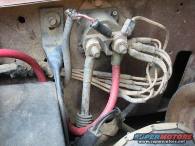

Yo HunterD,
Here is Starter Relay pic in an 88
Source: by Jem270
Ensure inner fender mounting area is clear of rust. grime, paint, etc because the relay's body grounds tbere.
