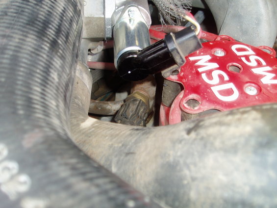

A guess ( and would show up in the self test KOER is da Engine Coolant Temperature (ECT) Sensor (passenger side of intake manifold, front, behind distributor
A pic by JP
"This measures the temperature of engine, and has a great impact on fuel ratio. This makes simple work of enriching the mixture on start up, overheating, and full throttle fun. It also allows us to lean out the mixture at certain times, to shorten the time it takes to warm up the engine helping us get great fuel economy. The Engine Coolant Temperature (ECT) sensor is a thermal transistor, which means it allows less electricity to pass through the sensor the warmer it gets. The ECT receives the
