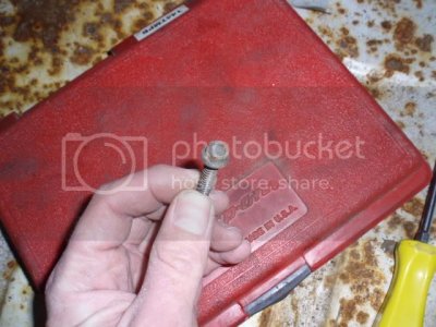

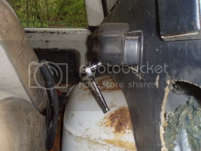

they are held on by two bolts with 5/16 head. I had no problem getting a 1/4 drive 5/16 socket in. the hole is the correct size for this and it self centers.

its alright man. i tried the ***** driver first, then a few sockets before i got the right one. And i've taken them off a few times before:). If you tried to use a 3/8 drive socket it would never fit, needs to be a 1/4 drive or some sort of nut driver.
