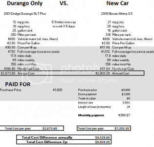

But on a side note, technology is neat. My 01 Durango with the modern 4.7 - I was able to swap the TCM (Tranny Control computer) to one from an 03 Jeep Grand Cherokee which turned my 4 speed auto into a 5 speed. Went from 18mpg to 22mpg @70ish mph.
If I could get THOSE numbers in my Bronco.. I only got a 1mpg from a new exhaust system.
But yes, operating costs as another member posted.. if you really crunch the numbers, it's amazing how much vehicles cost!
Works great if you don't NEED a new vehicle (I love my 01 Durango, mint, fully loaded, runs perfect, no leaks and good power)
