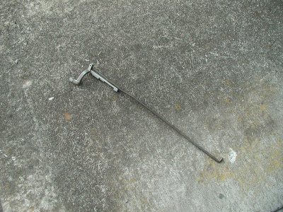

i have broken the cast aluminum bar that goes from the lock cylinder on my 89 down to the actual switch on the steering column under the dash. If that breaks then your lock will just spin. in my 85 i bypassed the switch completely for start function and use a push button. I turn the key to on, flip a toggle and push a button. This wasnt to fix the problem you speak of but because someone lost my key at one point. But this does remove all the strain on the cylinder during cranking.
do you know exactly which part is breaking?

that cast aluminum piece is what i broke. instead of replacing it i just drilled and tapped the rod and screwed the thing back together with some metal puddy on the threads of my *****. It has been working for 2 years now:) The part is only a few bucks from the dealer but i needed it fixed in a hurry. Thankfully when it broke on my the ignition was actually in the ON position so i could start the vehicle by crossing the terminals on the starter relay, and thankfully this way bypasses the clutch switch cause i was by myself:)
