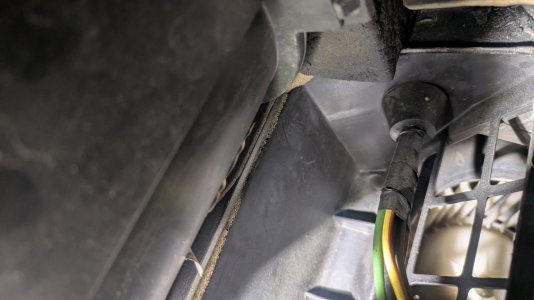

Then I started looking in the footwell and behind the glovebox for something else that might need to be replaced. As depicted below, I can see the wheel from inside the blower motor from the footwell. I'm not Ford Engineer, but seems like I shouldn't be able to see that. However, I don't even know what to search up to replace/fix that problem. Nothing looks broken and there are no empty holes where fasteners of something else should be. Puzzled. Any help or advice would be greatly appreciated.

If the recirculation door is open. Like on Max AC, I think you can see the blower motor.
Either way, for right now, that will not stop you from getting air, it would just be pulling air from inside the cab instead of outside.

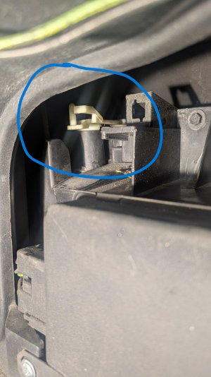

On closer inspection, I noticed this arm looks like it should have a cable or lever on it to do something. Anyone know if this is true and what it's purpose is? When I turn the heater on, I get some air blowing out of the vents, but it is merely room temp. Perhaps this arm has something to do with that? It's located on the top of the plastic contraption, towards the left, behind the glove box.

Looks like the PO really gutted it.

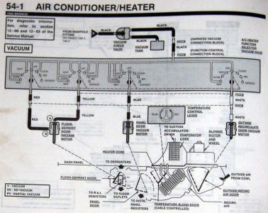

Below is a diagram.
I think there are 3 actuators, two under the dash and one under the hood. if you move that white lever do you get heat or air flow?
Default air flow is to defrost the windshield. So check there for air flow.
the lack of heat could be from the blend door in the wrong position which I would imagine is what you took a picture of, so if you move that lever does the temp change? can you just put a rubber band or zip tie on it for now?
If you are missing the actuators, then are you missing the vacuum lines? Might be worth going to a junk yard and just grabbing everything if you want to restore it to original working condition.
Below is a diagram.
