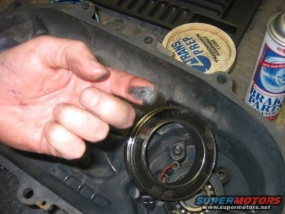

"those blisters from the heat are a result of it spinning behind the "gear" its pushing against" by kf4amu

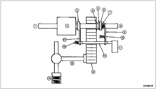

Item Part Number Description 1 7017 Input Shaft 2 7A398 Front Planet 3 7100 High-Low Collar 4 7177 Sprocket, Drive 5 7G361 Electromagnetic Clutch 6 7106 Lockup Sleeve 7 7D126 Lockup Spring 8 7061 Output and Fifth Gear Drive Shaft, Rear 9 7289 Shift Fork, 4WD 10 7219 Lockup Release Spring 11 7G360 Transfer Case Shift Motor 12 7A029 Drive Chain 13 7061 Output and Fifth Gear Drive Shaft, Front 14 3B396 Hub, Auto Locking 15 7N095 Shift Shaft 16 7W074 Range Shift Spring 17 7289 Shift Fork, Range
by Ford

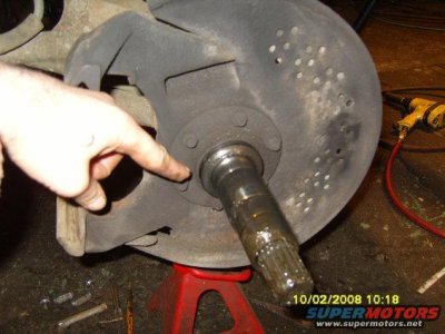

Pic by waltman  in an 89.  More pics @ http://www.supermotors.net/registry/10222/62538-2
The spindle woukd need to be removeed to inspect thr needle bearings.  Most likely these bearings haven't been lubed; often ovelooked by most shops.
What year do you have?
Dana 44 Spindle Differences 94-95; "...In addition to the ~'92 loss of a spindle stud (leaving 5) and the addition of 2 notches in the spindle ****** for the 4WABS sensor used on '93-96 Broncos only, the spindle was also redesigned in ~'95. to match the revised 2-piece inner wheel seal. F150 spindle flanges were never notched or drilled for the 4WABS sensor, but are otherwise identical to the corresponding Bronco's. I suspect the slot was lengthened around '86 for the self-locking spindle nut, but I haven't confirmed that. '87-early '88 spindles for manual (top-hat ******-style) hub locks are significantly shorter overall, and have 6 stud holes..."
