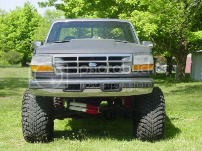

can someone post some pics of their single and dual stabilizer setups? i'm treading on new turf here so pardon the ignorance on my part. but, i'd like to see exactly where they go so i can make a final determination. i plan on ordering the kit here shortly.

anyhow back to original topic. anyone have pics of the stabilizers on their broncos? i just need a visual to put in my mind. to the site owners credit (or lack of depending on your view of it) he did say he usually doesn't recommend a dual stabilizer unless the customer is doing alot of high speed off roading. which may or may not be the actual case in a bronco. but, i do appreciate the fact that he didn't force it on me just to squeeze some extra money out of me. so anyhow i guess my question was/ is is it overkill? or just a good idea for the long term. right now i'm leaning towards the latter.
here's a pic of the dual stabilizer. for what it's worth, i didn't feel any difference at all after i installed them. i just thought they looked cool.

Whats with the grenade launcher hiding behind the bumper?
that is a long @ss bolt with a stack of strategically placed washers to shim the bumper out a little from the fenders to make clearance for the tires. :))
