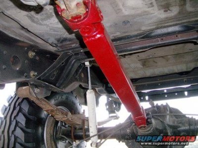

Check that the rear axle pinion yoke is pointing up at the t-case rear output yoke. the driveshaft should be close to straight in at the rear axle yoke. Ideal is to be 1-2 degrees below the axle yoke, so when you aplly power and the axle wraps up, the driveshaft is coming straight into the yoke. If the angle is off more than that, it puts the u-joint in a bind. To correct a bad angle, you need to use shims or wegdes under the springs. Be sure the leaf spring u-bolts are tight, too. If you need a pic to help explain the set-up, let me know. JSM84

IF the noise is coming from the DC joint, then it could be bad or worn out. While building that sqaure tubing driveshaft, i tore down the front driveshaft off the 86 Bronco to get that section. the center yoke where the ball bearing and spring go was totally crapped out, and came out in pieces. I was able to use the new DC joint from the F-350 driveshaft. That one cost me $300 and change to have rebuilt at a driveline shop, since those DC u-joints are often alot higher than the end ones. JSM84
