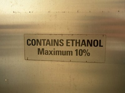

I have noticed that if I buy gas from a place that says they are using 10% ethanol which cost about 5 cents less per gallon I get a mile or two less per gallon. So I buy 100% gasoline from places like BP or Phillips 66 because that 5 cent difference ain't worth it when 12-15 mpg city is about as good as a 4x4 v-8 like the Bronco is going to get.
Tennessee Jed
Jul 8, 2007
183
I think it has to be right there near the octane rating. It will say it clearly near where the pump handle is.
Many convenience store chains and discount places like Walmart, Kroger, Food City etc. that also offer cheap fuel prices will have alcohol and if they were say 20% cheaper it might be a deal, but they are typically about 5 cents cheaper and that ain't enough for the loss of mileage.
These are my observations and are in no way to be considered as fact, so try and notice for yourself if there is a decline when using these products.
