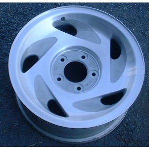

You are right, the 17s are 5 x 135 and I placed a wheel hole gauge using the 5 x 5.5 holes and they match up dead nuts on the 5 x 135 studs of the Expedition. Mathematically 5.5 in comes our to 139.7 mm so I'm not sure why the gauge set perfectly on all 5 studs. I won't know for sure until I try mounting one, which I will be doing this weekend as a test. I'll let you know how it works out. If this doesn't, I'll resell them and pay the price to have a set drilled or just forget it for now and use my set of 15 x 5.5 x 8 wheels with new 33s on them.
Yea, they are real close, but when the studs come through you will find they will not center in/on the hole off by just a couple of mm's. Its heartbreaking because the wheels look very unique on the Bronco.
If you get them to fit please post us a pic...please...I am beggin' here.

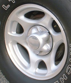

That third picture is the set I have.
Now to each his own, but this ain't rocket science. It's machine work. Accurate drilling & countersinking, that's it. For anyone familiar with a lathe & mill this is just a layout problem. You should be able layout the correct pattern, drill the hole offset & then countersink them for the lugnuts, or, well any machinist willing to take $$$ for his work should be able to. It's just a math problem (more specifically it's a geometry problem. Most of us learned this back in high school).

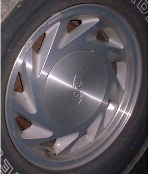

The E-150 vans had some nifty mag wheel designs that look cool on a Bronco from similar model years, I have them pictured in earlier post, same offset and lug pattern but also same old 15" diameter. You would have to fabricate front lug covers with holes for your front axle/lock hubs.
This place may even trade in the ones you have for some Ford factory styles that will fit.
Here is a page that has some of the styles that should fit the Bronco from vans just fine.
