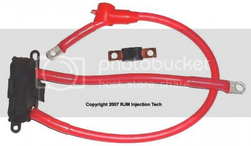

Now what about bigger cables? Ive seen many people run a 2 guage wire and inline fuse. I see that RJM injection has 2 guage cables and a big inline fuse for 40 bucks. Is this absolutely needed? Heres a picture of the cables.

I'd go with Ryans cable kit.. but check local Auto Electric Repair Shop for prices.
