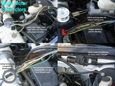

There may be two connectors required for the wiper motor depending on production date.
One plug with 6 wires or two plugs with 3 wires each.

Well actually I figured out the short but now my wiper motor isn't working
I found the larger plug in on the side and checked that but then found a wire burnt up thats a green and black two prong connection but not sure where it goes to splice it back
If you could supply pictures, that would be helpful. If not, then you need to use MANY more words in your description to paint a picture of your problem so that we can help.
