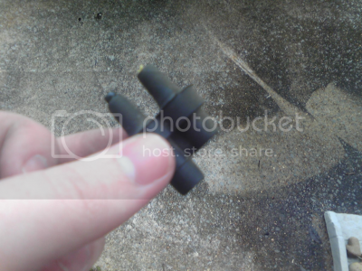

untitled_zpsa235f84f.png[/img]
Found my problem, or at least on of them, thanks for the help miesk5! i will go get the part in the next day. If anyone else has experienced these problems just check the ends of where everything vacuum is connected because this looked correct until i touched it and it moved freely. Thanks again! ill post if it fixed
