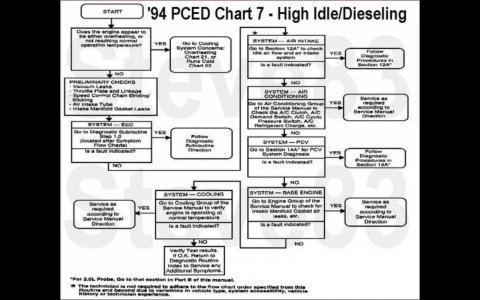

Yo Johnny
Check throttle plate and linkage for binding, etc as shown in below chart.
See my Vacuum leak test in post #11 @ https://www.fullsizebronco.com/threads/help-with-dtc-codes-and-idle.206824/
Tip, if the leak exists in an accessory unit, such as the power brake, the unit will not function correctly. Or Air Conditioning when in MAX mode may switch to Defrost
