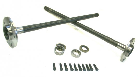

8.8” rear ends generally have 31 spline axles by http://www.badshoeproductions.com/rear.htm
Confirm @ https://shop.broncograveyard.com/Ford-88-Axle-Shafts/products/416/
Ford Bronco & Truck 8.8 Inch HD Axle Set With Bearings, Seals & Studs
New
Ford 8.8 Inch Rear Axles 31spline
1987-96 Ford Bronco
1987-96 Ford Truck
Passenger and Driver Axle
Wheel Bearings, Seals and Wheel Studs
FORD 8.8-INCHThe 8.8-inch debuted in 1983 Broncos and F-150s, and is now found also in 4.0-liter Rangers and Explorers/Navajos. It is easily distinguished from a 9-inch by having a cover on the back.
148
Mustangs and maybe a few explores were the only ones to get the lighter splines. Bronco 8.8s always got the 31 count.
