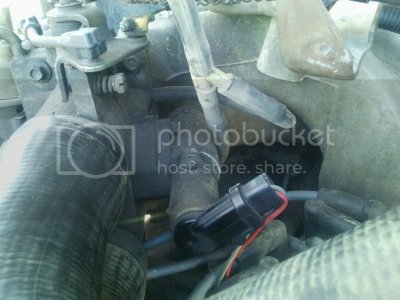

Yeah I found that same diagram on the one in my hood, but unfortunately my mechanical skills are lacking, ********. So I have attempted to include pictures, so if anyone can tell me where these are coming from and going to (supposed to anyway) that would be great. Thanks - Dalton
http://2012-11-10105455.jpg[/img]
http://2012-11-10105503.jpg[/img]
Elmo
Dec 2, 2008
417
Forsyth Georgia
that is the connection for the canister purge silinoid on my truck with a 5.8 not sure if it is the same for the 5.0 but it defff does not need to be open cap it off and see if it makes any improvement
yo,
As ELMO advised, cap it off and see if issues are cleared-up. That appears to be an in-line splice connector @ end of hose; so see if it will mate up to any other loosed ended vac hiose nearby or on other side of manifold or Throttle Body.

Well, I solved the issue with my truck. A connector behind the battery near the sellenoids was loose, and I reconnected it and all is good now. Im not sure what its called, but it idles smooth and all the smoke is gone.
As far as that other vac hose, I tried putting my thumb over it, and blowing into it while idleing, and it didnt make a difference. What should I do with it? Thinking its a dead hose. Not sure.
yo D,
Great!
I'd secure the hose & leave it there; tape open end and maybe use it down the road in case another sim sized hose fails
