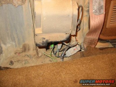

Seat Belt Warning Chime Module and Wiring
Check Connector, etc. on each bucket or bench seat belt where it mts to floor pan
Connector Corrosion @ driver side seatbelt retractor panel
Source: by Jem270
17 — To Warning Buzzer Chime View is from engine side

i took the cover off where the drivers side seat belt is wound up under the rear speaker and it was corroded more than anything ive seen on this truck so far i took it apart and re wired it...but still if i drive even at 25 mph the seat belt light still doesnt come on...am i wrong thinking that...or do these trucks actually start chimeing with the seatbelt off? the light nor the chime come on if iam driving without a seat belt..reason i want this to work is my nephew is learning to drive on this truck and he absolutely hates that chime so what better way to break in wearing a seat belt? plus i really want to restore all the chime's and lights to origional
