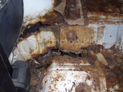

the jute pad under the rubber mat holing all the moisture will be worse for your floor than with it out. Trust me on that one.
I dont recommend just running bare metal floor, I would at least use some sort of truck liner.
where is your truck leaking from?
i found alot of bad surprises when i pulled my rubber mat out.
