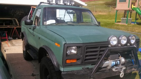

Damn man, thats pretty cool, how hard was it do? Also do you think it would cover small hole where trim fell my truck, or its it not heavy enoght?
By itself, it's not that heavy. But what I did was use a little dab of that weather seal adhesive to dab in there, and let that set for a little bit, then I just rolled GG right over it. You can't see any of the little pinholes I had in the fender from before I started.

Sort of a 4x4 rat rod. Simple, cheap, basic & effective. That's a hard combo to beat. It's something that almost anyone can do at home without needing to shell out $3K to a shop.
I did some concrete work last fall for a guy that does auto body repair. We had a few beers and I picked his brains over what I needed to do.
Basically, I spent half the day masking around the windows, bumpers, removing the grill and headlight bezels, taillights and mirrors. Prep was simple, wash, dry, then scuff it with a greenie pad soaked in xylene. Dab in some rust-x to chemcially stop any rust, and some weather seal adhesive to fill in the pinholes.
I rolled on the first coat, that took about 2 hours and a gallon of paint. That's where I left it for the first day. On the 2nd I used up another gallon and laid on a 2nd coat, then touched up a few little places with some stain brushes. about an hour later it was tacky to the touch, and I pulled off all the masking, then went around with another touch up coat, and did the insides of the door (around the hinges and door stricker / jambs.
I rolled on a 3rd coat on the leading edge of the hood, along the rocker panels, and around the fender wells, thinking those areas would see the most abuse.
Two days in a garage, and this is the result. I'm pretty happy with it.
If you can slap paint on a bedroom wall, you can do this.

How would you think it would do as a sound deadener? My thoughts is to use it behind all the panels and under the carpet to cut down on the road noise.... How thick is it??
I'd figure it's around an 1/8th of an inch thick, maybe a little less. Fairly dense, too. It does a pretty good job of cutting down the road noise, and it'll only make it better when I get around to doing the inside.

I've got a 91 that has been painted over twice before i got it, I am looking into monstaliner but not liking the colors they have.
How is this product holding up?
Bebop Man
Dec 26, 2007
257
Rapid City, SD
Pretty good.  I did end up touching up the color in 2013.  I just used Rustoleum rattle-can.  Outside of that, I haven't had to do any maintenance on it.
